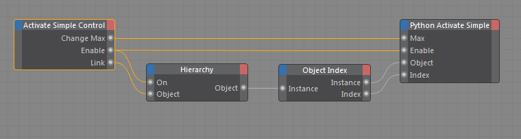

On 05/01/2015 at 04:53, xxxxxxxx wrote:
Hi, I'm glad this has already been solved. I was working on this and got held up by Christmas vacation... But as I came up with an example, I thought I post it nevertheless.
"Activate Simple Control" is a NULL object with three User Data values: Change Max (integer), Enable (Bool) and Link (a link field).
The Python code in "Python Activate Simple" is quite simple:
import c4d def main() : if not(doc) or not(Object) : return flagSelect = (Index < Max) or (Max < 0) # activate all on negative values Object[c4d.ID_BASEOBJECT_GENERATOR_FLAG] = flagSelect
On 05/01/2015 at 05:50, xxxxxxxx wrote:
Thanks for taking the time to come up with this elegant solution! I really appreciate it.
