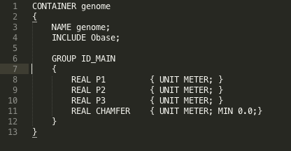

    So here's my .res file, and the accompanying errors. I don't even know what the first one is even referring to. The second one seems to be some sort of formatting error, and since I don't know C++, I'm not able to interpret it. Everything seems to be formatted exactly like all the other example plug-ins I've looked at, so I'm not sure what's wrong with this one.
    I should note that every time I make a modification to the code, I will delete the symbolcache file at:
    User --> Library --> Preferences --> MAXON --> C4DR13... --> Prefs
    Any help would be greatly appreciated.
    Here is an image of the code with correct spacing, etc if needed:
    http://www.lukeletellier.com/wp-content/uploads/downloads/2012/09/res-code.png

    To your code: Have you actuall added a resource-header and stringtable? You do not mention something about them. It is not enough to just have a resource-file. Cinema would not know the name of the element (in the GUI) nor the integer-ID the symbol is assigned to. Therefore, you need to more files.
    The first error looks like you haven't specified the name of the genome symbol. When you insert the NAME genome; command, a name must be assigned to the given symbol.
    The second error looks like you did not define an ID for the P1 symbol.
    Additionall, the first group in an Object Plugin is usually called ID_OBJECTPROPERTIES , not ID_MAIN.

    Hi Luke,
    to the symbolcache thing: I don't know how Cinema 4D handles this internally. I guess this is the normal behaviour. It doesn't seem to result in any issues. Note that Cinema 4D start-up will slow down when you really delete the symbolcache every start. It will need to go through each resource-header from the application itself and third-party plugins to retrieve all the symbols that are used in Python and COFFEE. And these are quite a lot of files which can take some seconds.
    The the naming-conventions: It's simple. You have added symbols to be used for your plugin. One of your symbol, just for example, is "UPDATE" with id "1001". Cinema 4D will parse your resource-header (Genome.h) and add this to Pythons and COFFEEs symbols (and write it into the symbolcache). This way, you can access your symbol via the C4D module. (print c4d.UPDATE will print "1001"). The problem is, that no one except you actually knows what "UPDATE" refers to. That's why every symbol is prefixed. (MSG_, COPYFLAGS_, DIRTYFLAGS_, VIEWCOLOR_, PRIM_, etc.). You should prefix every of your symbol with what it refers to. I.e. "UPDATE" turns into "GENOME_UPDATE", "CREATEXPRESSO" turns into "GENOME_CREATEXPRESSO", etc.
    The next thing is more a minor thing, but plugin ID symbols (such as Ocube, Tdisplay, Mmaterial, Xbitmap, etc.) are prefixed as well. As you might have guessed, object-plugins with "O", Tags with "T", Materials with "M", Shaders with "X", etc.
    This again makes it easier to identify what the symbol refers to. Also, prefixing the names with what they refer to avoids name-collisions.
    You don't have to stick 100% with the naming of Cinema 4D, but the prefixing-issue is very important.
    I'm currently working on a C++ plugin suite I called Pr1mitive as it implements some new primitives for Cinema 4D and other features. I have chosen a strict naming-convention that I apply to all parts of the project (which doesn't mean to every project I'm working on). Here's an excerpt from my resource-files for a parametric Pillow object (well, looks like a pillow).
    Opr1m_pillow.h
    // coding: UTF-8
    // Copyright (C) 2012, Niklas Rosenstein
    #ifndef _OPR1M_PILLOWSHAPE_H_
    #define _OPR1M_PILLOWSHAPE_H_
      enum {
          Opr1m_pillow = 1028986,
          PR1M_PILLOW_SIZE = 1000
    #endif // _OPR1M_PILLOWSHAPE_H_
    Opr1m_pillow.res
    // coding: UTF-8
    CONTAINER Opr1m_pillow {
      NAME Opr1m_pillow;
      INCLUDE Obase;
      GROUP ID_OBJECTPROPERTIES {
          VECTOR PR1M_PILLOW_SIZE { MIN 0 0 0; UNIT METER; CUSTOMGUI SUBDESCRIPTION; };
      INCLUDE Opr1m_complexshape;
    Opr1m_pillow.str
    // coding: UTF-8
    STRINGTABLE Opr1m_pillow {
      Opr1m_pillow        "Pillow Shape";
      PR1M_PILLOW_SIZE    "Size";
    -Niklas
