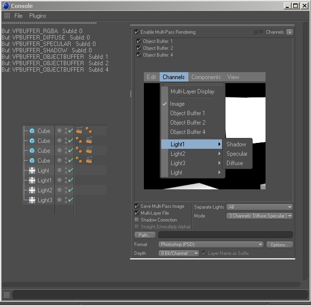

On 22/08/2007 at 19:11, xxxxxxxx wrote:
Hi all,
Here the scene that i've examined:
i wrote this piece of code looking for the separate light pass:
LONG *remapVpBuffers = (LONG* ) GeAlloc (sizeof(LONG)*33);
          String *remapStrings = (String* ) GeAlloc (sizeof(String)*33);
          remapVpBuffers[0]      = VPBUFFER_RGBA;
          remapVpBuffers[1]      = VPBUFFER_AMBIENT;
          remapVpBuffers[2]      = VPBUFFER_DIFFUSE;
          remapVpBuffers[3]      = VPBUFFER_SPECULAR;
          remapVpBuffers[4]      = VPBUFFER_SHADOW;
          remapVpBuffers[5]      = VPBUFFER_REFLECTION;
          remapVpBuffers[6]      = VPBUFFER_TRANSPARENCY;
          remapVpBuffers[7]      = VPBUFFER_RADIOSITY;
          remapVpBuffers[8]      = VPBUFFER_CAUSTICS;
          remapVpBuffers[9]      = VPBUFFER_ATMOSPHERE;
          remapVpBuffers[10]      = VPBUFFER_ATMOSPHERE_MUL;
          remapVpBuffers[11]      = VPBUFFER_ALLPOSTEFFECTS;
          remapVpBuffers[12]      = VPBUFFER_IMAGEBUILDING_PASS;
          remapVpBuffers[13]      = VPBUFFER_DEPTH;
          remapVpBuffers[14]      = VPBUFFER_MAT_COLOR;
          remapVpBuffers[15]      = VPBUFFER_MAT_DIFFUSION;
          remapVpBuffers[16]      = VPBUFFER_MAT_LUMINANCE;
          remapVpBuffers[17]      = VPBUFFER_MAT_TRANSPARENCY;
          remapVpBuffers[18]      = VPBUFFER_MAT_REFLECTION;
          remapVpBuffers[19]      = VPBUFFER_MAT_ENVIRONMENT;
          remapVpBuffers[20]      = VPBUFFER_MAT_SPECULAR;
          remapVpBuffers[21]      = VPBUFFER_MAT_SPECULARCOLOR;
          remapVpBuffers[22]      = VPBUFFER_ILLUMINATION;
          remapVpBuffers[23]      = VPBUFFER_OBJECTBUFFER;
          remapVpBuffers[24]      = VPBUFFER_POSTEFFECT;
          remapVpBuffers[25]      = VPBUFFER_POSTEFFECT_MUL;
          remapVpBuffers[26]      = VPBUFFER_AMBIENTOCCLUSION;
          remapVpBuffers[27]      = VPBUFFER_MAT_NORMAL;
          remapVpBuffers[28]      = VPBUFFER_MAT_UV;
          remapVpBuffers[29]      = VPBUFFER_MOTIONVECTOR;
          remapVpBuffers[30]      = VPBUFFER_BLEND;
          remapVpBuffers[31]      = VPBUFFER_LIGHTBLEND;
          remapVpBuffers[32]      = VPBUFFER_ALPHA;
          remapStrings[0]      = "VPBUFFER_RGBA";
          remapStrings[1]      = "VPBUFFER_AMBIENT";
          remapStrings[2]      = "VPBUFFER_DIFFUSE";
          remapStrings[3]      = "VPBUFFER_SPECULAR";
          remapStrings[4]      = "VPBUFFER_SHADOW";
          remapStrings[5]      = "VPBUFFER_REFLECTION";
          remapStrings[6]      = "VPBUFFER_TRANSPARENCY";
          remapStrings[7]      = "VPBUFFER_RADIOSITY";
          remapStrings[8]      = "VPBUFFER_CAUSTICS";
          remapStrings[9]      = "VPBUFFER_ATMOSPHERE";
          remapStrings[10]      = "VPBUFFER_ATMOSPHERE_MUL";
          remapStrings[11]      = "VPBUFFER_ALLPOSTEFFECTS";
          remapStrings[12]      = "VPBUFFER_IMAGEBUILDING_PASS";
          remapStrings[13]      = "VPBUFFER_DEPTH";
          remapStrings[14]      = "VPBUFFER_MAT_COLOR";
          remapStrings[15]      = "VPBUFFER_MAT_DIFFUSION";
          remapStrings[16]      = "VPBUFFER_MAT_LUMINANCE";
          remapStrings[17]      = "VPBUFFER_MAT_TRANSPARENCY";
          remapStrings[18]      = "VPBUFFER_MAT_REFLECTION";
          remapStrings[19]      = "VPBUFFER_MAT_ENVIRONMENT";
          remapStrings[20]      = "VPBUFFER_MAT_SPECULAR";
          remapStrings[21]      = "VPBUFFER_MAT_SPECULARCOLOR";
          remapStrings[22]      = "VPBUFFER_ILLUMINATION";
          remapStrings[23]      = "VPBUFFER_OBJECTBUFFER";
          remapStrings[24]      = "VPBUFFER_POSTEFFECT";
          remapStrings[25]      = "VPBUFFER_POSTEFFECT_MUL";
          remapStrings[26]      = "VPBUFFER_AMBIENTOCCLUSION";
          remapStrings[27]      = "VPBUFFER_MAT_NORMAL";
          remapStrings[28]      = "VPBUFFER_MAT_UV";
          remapStrings[29]      = "VPBUFFER_MOTIONVECTOR";
          remapStrings[30]      = "VPBUFFER_BLEND";
          remapStrings[31]      = "VPBUFFER_LIGHTBLEND";
          remapStrings[32]      = "VPBUFFER_ALPHA";
          GePrint ("************************************************");
          VPBuffer *Buffer=NULL;
          for (LONG lb=0; lb<33; lb++){
               for (LONG subId = 0; subId<50; subId++) {
                    Buffer = render->GetBuffer(remapVpBuffers[lb],subId);
                    if (Buffer) {
                         GePrint("Buf: " + remapStrings[lb]+ "   SubId: " + LongToString(subId));
                         if (lb == 0) break;
gefree etc.etc.etc..
Now..why all others lights layers are not in the list?
Thanks all
Renato

On 27/08/2007 at 03:17, xxxxxxxx wrote:
Here's how to browse through a multipass bitmap. For lights there is an inner loop that retrieves the data.
The main bitmap should be checked with bmp->IsMultipassBitmap() first and then casted into a (MultipassBitmap* )
     LONG j,i,id;
     LONG cnt = b3d->GetLayerCount();
     for (i=0; i<cnt; i++)
          MultipassBitmap *sublayer,*layer = b3d->GetLayerNum(i);
          if (!layer) continue;
          LONG subcnt = layer->GetLayerCount();
          for (j=0;j<subcnt || subcnt==-1;j++)
               if (subcnt>0)
                    sublayer   = layer->GetLayerNum(j);
               else
                    sublayer = layer;
               if (!sublayer) continue;
               id = sublayer->GetParameter(MPB_USERID).GetLong();

On 28/08/2007 at 12:26, xxxxxxxx wrote:
You can retrieve the main bitmap by calling
MultipassBitmap *mpb = (MultipassBitmap* )renderinstance->GetBuffer(NOTOK,0);
