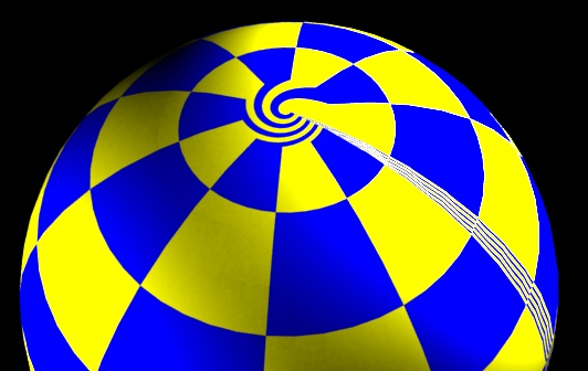

On 21/12/2006 at 07:53, xxxxxxxx wrote:
I all,
i'm trying to get the projected UVW from volume data and texdata.. but always i'm getting this problem with the spherical projection.
What's the correct way to get stored and prepared UVW in VP_INNER?
I've used ProjectPoint and return me some artifact.
Renato T.
On 22/12/2006 at 15:46, xxxxxxxx wrote:
What i mean is:
When c4d prepare the geometry accessibile in the volumedata i imagine that store in UVW all kind of projection.
But i don't understand how to get the "spherical" or "flat"   transformed UVW. GetUVW fill the UVW polyvector only for the UVW mapped object. I can't trust that ProjectPoint is called when rendering.
thanks in advance and merry xmas to all :)
Renato
