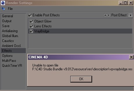

On 27/10/2006 at 09:08, xxxxxxxx wrote:
Nothing, i still have this problem and i've checked all properties for all projects inside my solution.
Still my VrayBridge is looking when exectud the res inside the main c4d resource instead my plugins/vraybridge/res
Thanks all for the help
Renato T.
On 27/10/2006 at 14:30, xxxxxxxx wrote:
wow, is this actually the first image of the vraybridge?
am i allowed to post it @ cgtalk?
