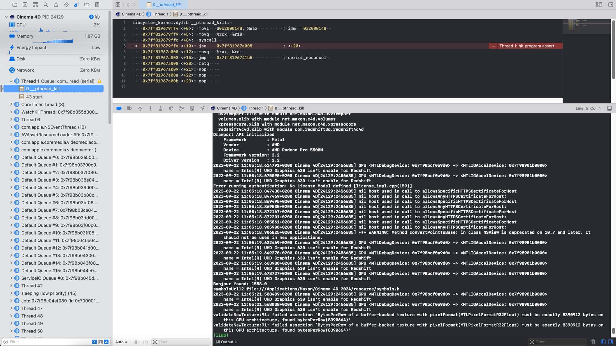

Follow-up: C4D 2024 (latest release, just downloaded from Maxon website)
Tried on the same system as before: 2019 MacBook Pro, Xcode 13.2.1 using legacy build system, macOS Monterey 12.6.8.
www.frankwilleke.de
Only asking personal code questions here.
Redshift sure complains a lot in the debug console.
Should I try and remove redshift.xlib from C4D 2023 and see if that changes anything?
www.frankwilleke.de
Well, well, well, there we have it. It's a Redshift issue! After removing the Redshift .xlib files from /corelibs and /Redshift, most of the error messages are gone, and so is the crash. Tested in C4D 2023.2.
www.frankwilleke.de
