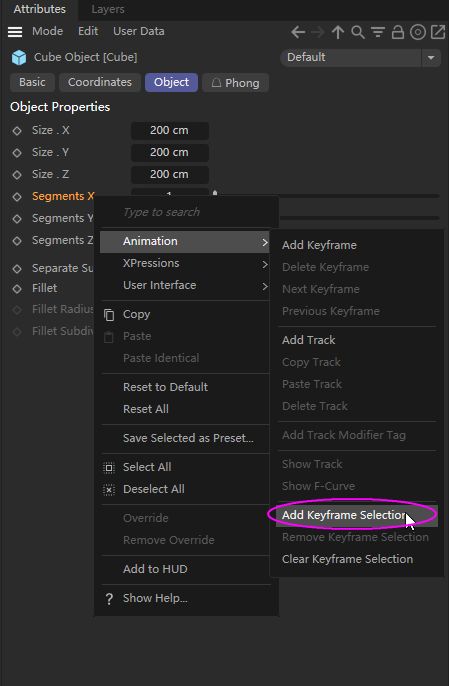

Solved Some functions can't be logged by script log, how do I implement?
Hi
There are a couple of functions (as shown in the picture) that are used quite frequently, so I'd like to write a script in order to set up a shortcut to those functions.
But I don't know how to start.
What keywords should I search for in the SDK?
Thank you
Hi @freeter_e not all commands are registered by the CallCommand, only a few of them this is due to the architecture of Cinema 4D itself, and nothing that is trivial to fix.
With that's said we provide specif API for many elements in Cinema 4D. So find bellow an example on how to use the KeyFrame Selection.

Regarding you second request, this is not possible to control the Asset Browser Dialog.
If you have any other question, please let me know. But in the future try to open a topic for each question (in this case one for the KeyFrameSelection and another one for the Asset Browser).

But this can only be implemented specific (it needs to be written in a script), I want a more free interaction, more "random" selection, depending on the current mouse selection (highlighted).
action "right click --> animation --> add keyframe selection" become a shortcut

Sadly it is not possible to retrieve the selected parameters.
