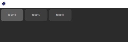

i want to show text something when cursor in gui element.
But I can only display some text when the mouse is stopped, I hope different GUI elements display different text. (For example, if there are different buttons in a window, when the mouse is stopped, the information of the current button will be displayed.)
BitmapButtonCustomimGui can achieve this effect. How can button gui achieve this effect?
example dialog:
my code:
def Message(self,msg,result):
    msg_id = msg.GetId()
    if msg_id == c4d.BFM_GETCURSORINFO:
        result.SetId(c4d.BFM_GETCURSORINFO)
        result.SetString(c4d.RESULT_BUBBLEHELP, "Show something")
    return c4d.gui.GeDialog.Message(self, msg, result)
Thanks for any Help!
