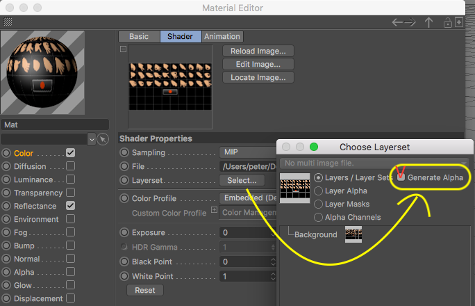

Hello everyone.
I am stuck at a dead end wall while working on python.
using python
Layerset
I want to turn on the Generate Alpha option.
CallButton() and
I tried Layerset.SetMode (mode), etc.
Failed.
Thank you for your sincere help.

What you want to do is unfortunately not possible. The internal C++ implementation of LayerSet has two methods named GetCalcAlpha and SetCalcAlpha. They have never been propagated to the public C++ class LayerSet and therefore also never have been exposed on the Python class of the same name. There is also no undocumented flag trickery you could do, as the Get/SetCalcAlpha methods use a private bool field on the internal interface and not any flags you could set from the public API.
