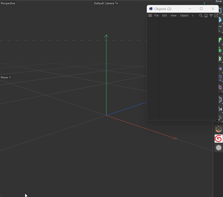

I'm on 2023.2.2 in C++.
My CommandData plugin creates a cube and inserts it into the document yet the object manager does not show the cube until I select it in the viewport.

My question is: Why does the first code not update the object manager?
Hi sadly this is a known issue, see EventAdd is not working.
