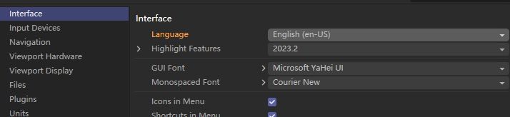

Solved How to get the Interface language of c4d
i want to get the interface language of c4d use python.
Thanks for any help
