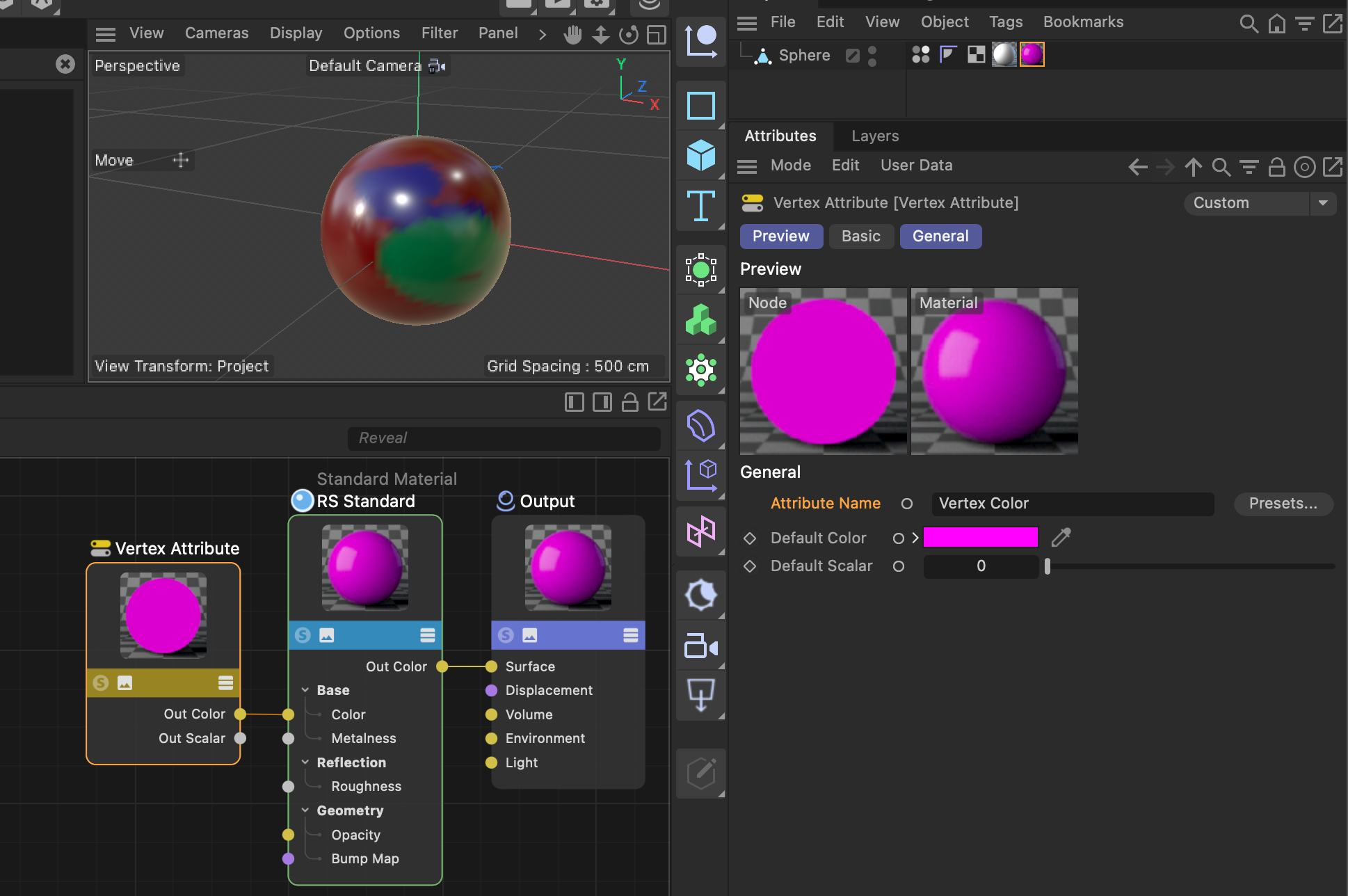

Hey @zauhar,
I do not think so that I have told you that, at least I hope so, because that what you say there is not quite correct :)
A vertex map or a vertex color tag can be rendered. When you use the standard renderer, you will have to use the Vertex Map shader, and when you use Redshift, you will need the Vertex Attribute node (just drag and drop the tag in both cases in the respective reference fields of the shaders). Below is an example for the Redshift case:
Other renderers support Cinema 4D vertex colors too, but you will have to ask their support how that works :)
Vertex Map Shader
Vertex Attribute Node
