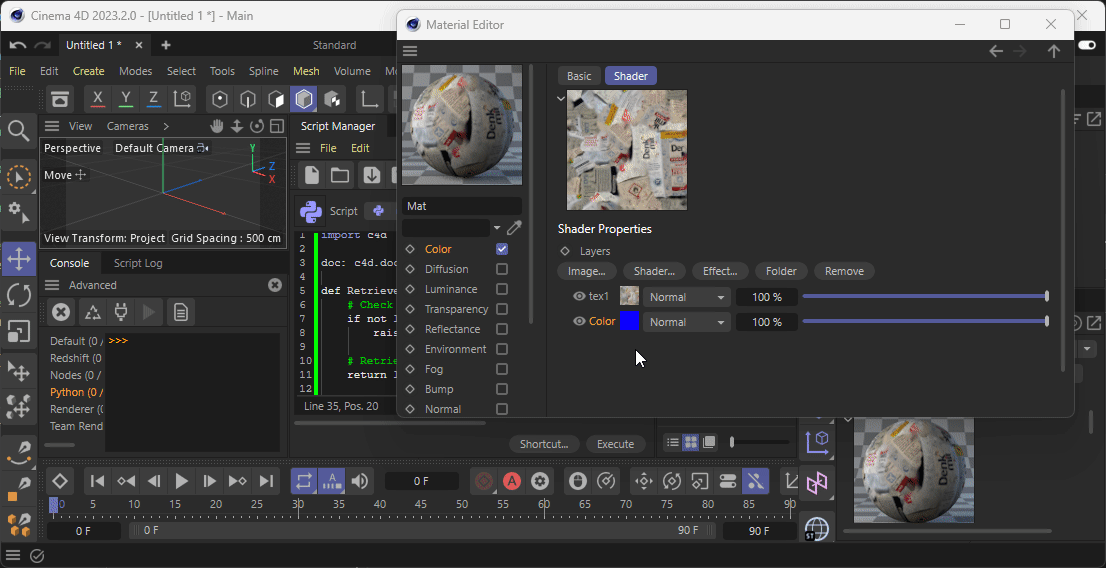

Today I was trying to link or access the color within a sahder layer only with python, I know I can get it and change its parameter in the same sahder layer, but my question is more about how I can enter one of these and change its data , as in this case the color, or also the direction of a bitmap.

Assuming your goal is to adjust shader attributes (color value for color shader and bitmap path for the bitmap shader), the snippet on the thread that I pointed you out to shows up exactly this case (for the bitmap path): How to change bitmap in layered shader?. I've sketched up the corresponding part for the color shader for you (please find below).
The c4d.LAYER_S_PARAM_SHADER_LINK parameter basically points to the object that contains the shader. Please, refer to the C++ documentation in this regard: LAYER_S_PARAM_SHADER. Some parts of our API are better documented on the C++ side, so it is worth double checking the missing parts there.
