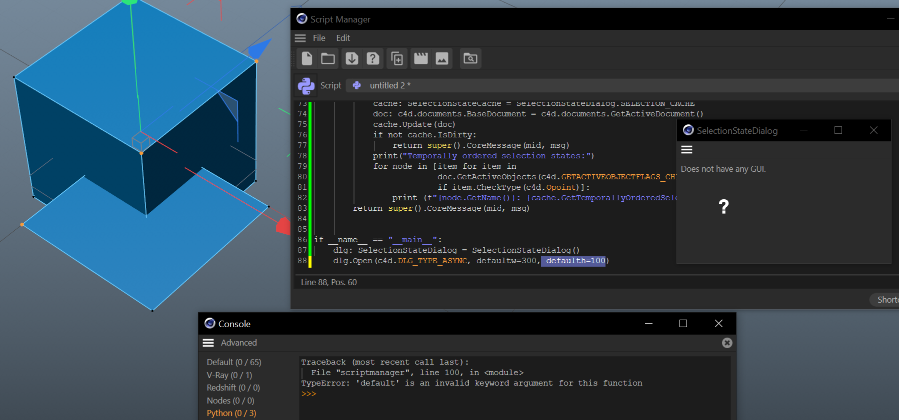

As expected, it's too difficult. And some of the code doesn't seem to work properly. Could you please upload the scene. thank you It has been resolved.
Hey @ymoon,
My apologies, I am not quite sure what happend there, but the h in defaulth was missing in my code listing. The code should run now, I updated the listing.
Ferdinands
It Works. Thank You
