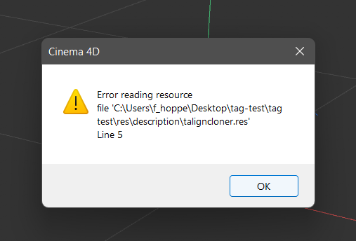

Hello everyone,
I am working on a tag plugin with cloner, I get a copy of teh Github py-look at camera.pyp example and start my first step with a tag plugin, the basic goal is stiky a link object to a index of a cloner object and also can be offset.
But I modifiy the example and test it, cinema always crash when apply the tag to an object. even I just return exe_ok ,
I don't know what is happend.

Hello @Dunhou,
I checked the code you provided. There was a wrong line in your res file.
 INCLUDE Taligncloner;
has to be:
 INCLUDE Texpression;
// The description defintion of the tag Taligncloner.
CONTAINER Taligncloner
    NAME Taligncloner;
    // The main "Tag" tab of the tag.
    GROUP ID_TAGPROPERTIES
        LINK LINK_NODE { FIT_H; ACCEPT { Obase; } }
        REAL CLONER_INDEX  { UNIT METER; STEP 1; }
        BOOL STIKY_ON_CLONER { }
Besides the fact that the object which is supposed to stick to the cloner jumps around each refresh, it now works for me in S26. ;-)

Hey @HerrMay ,Thanks for that!
What is the INCLUDE Texpression; means? Could you explain a little deeper, I did't find a document for those things:anguished:

Hello @Dunhou,
I'm not super sure about what INCLUDE Texpression means in regards to c4ds deeper resource implementation. I guess it's just the way to say how your tag plugin should be treated. That it should be calculated as an expression in c4ds execution pipeline, if that makes sense.

Hello @Dunhou,
Thank you for reaching out to us and thank you at @HerrMay for providing what I would think is the correct answer.
At least on my machine, nothing is crashing here, it is just that the description of the tag is malformed on line five.
In this case, it is such a severe error, that Cinema 4D fails to load the description at all because it is cyclically referencing itself. The keyword INCLUDE in a resource allows us to include another resource in that resource. And when we try to reference the resource, we are defining, Cinema 4D is understandably confused. For less severe descriptions errors, one usually is able to then lick OK a few times to get Cinema 4D to load what it does understand. But that does not work here, and one is caught in an endless loop of self-reference.
