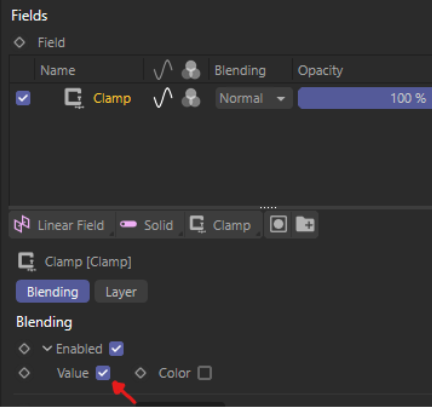

What I'm trying to change is this control.
John Terenece
hi,
for this, you must use the function SetFlags on the Field data and update the data on the object. The flag that must be set is FIELDLIST_FLAGS::CLAMPOUTPUT
Unfortunately, the UI do not update, you must deselect and reselect the object. I did not find anything yet to address this issue.
I used c++ this time to be sure nothing was wrong with python.
BaseObject* op = doc->GetActiveObject();
if (!op)
	return maxon::NullptrError(MAXON_SOURCE_LOCATION);
GeData data;
op->GetParameter(FIELDS, data, DESCFLAGS_GET::NONE);
FieldList* fl = static_cast<FieldList*>(data.GetCustomDataType(CUSTOMDATATYPE_FIELDLIST));
fl->SetFlags(FIELDLIST_FLAGS::CLAMPOUTPUT, false);
op->SetParameter(FIELDS, GeData(CUSTOMDATATYPE_FIELDLIST, *fl), DESCFLAGS_SET::NONE);
python code just in case
    fl = op[c4d.FIELDS]
    toggle = fl.CheckFlag(c4d.FIELDLIST_FLAGS_CLAMPOUTPUT)
    fl.SetFlags(c4d.FIELDLIST_FLAGS_CLAMPOUTPUT, not toggle)
    op[c4d.FIELDS] = fl

Thanks, that was exactly what I was looking for.
John Terenece
