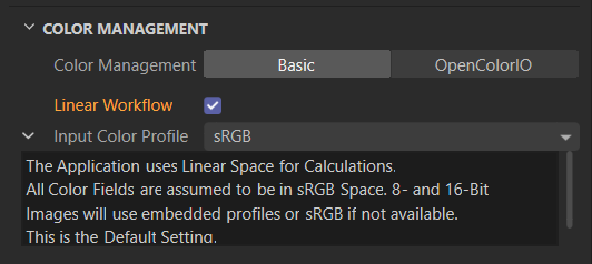

Thank you for reaching out to us. Your question is missing a key piece of information, which color management mode your render document is in. I assume your render document is either in Basic mode and has Linear Workflow enabled, or you are in OCIO mode.
Fig. I: The color management settings of document, press CTRL + D to open the Attribute Manager on them.
