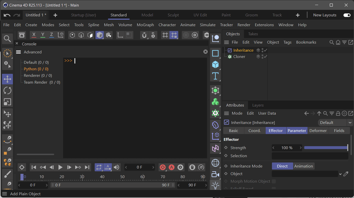

An uncomplicated way to find out these type symbols is the console and the method C4DAtom.GetType (all classic API nodes are of type C4DAtom). Drag the thing you are interested in into the console (e.g., the Inheritance object) and type after it .GetType() and press Enter:
