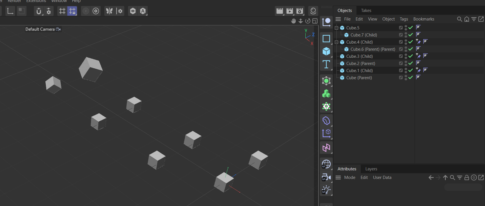

Hey @mats,
I ran your code, and I cannot reproduce your problem. The line tag( [c4d.ID_CA_CONSTRAINT_TAG_PARENT] = True is not really wrong but makes not too much sense as you are calling there C4DAtom.__call__, the line should be tag[c4d.ID_CA_CONSTRAINT_TAG_PARENT] = True.
I also added undo steps to your script, but it was working without them for me too. Maybe I am misunderstanding what you mean with 'When doing it manually, I get no offset on the objects, they all stay in place as intended.', but for me there is no 'offset'.
I ran the code on 2023.0.0 and 2023.1.0 to the same effect, find my code below. If the problem does persist for you, I will have to ask you to explain what you would consider wrong with the result.
The result:
The code:

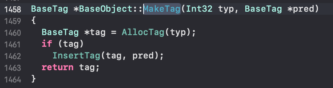

Hey @iplai,
That seems unlikely because all the method does, is free you from the burden of having to insert the tag yourself.
and when I change the relevant portion of my script to this,
tag: c4d.BaseTag = c4d.BaseTag(c4d.Tcaconstraint)
if tag is None:
    raise MemoryError("Could not allocate tag.")
child.InsertTag(tag)
the outcome is still the same. As I said, there is no real substantial difference between my code and the one from @Mats, I just rewrote the script to be cleaner.
