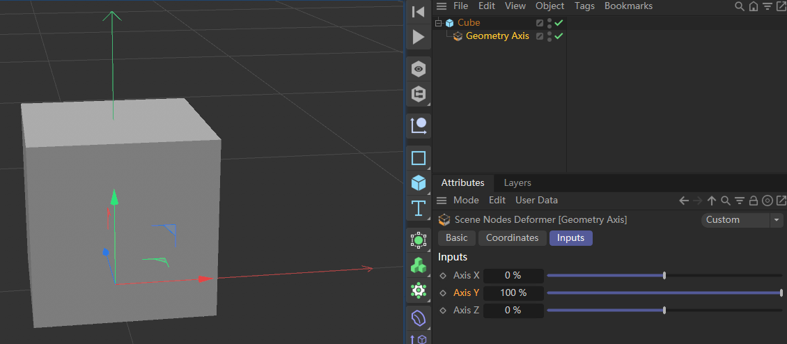

My script works and I got what I want, but there are two problems.
  • maxon.AssetManagerInterface.LoadAssets always return False event the asset loaded successfully.
  • I set the parameters of Geometry Axis by find the param's name. Is there a better way to change the parameters?

    cube = c4d.BaseObject(c4d.Ocube)
    loadGeometryAxis(y=1, parent=cube)
    doc.InsertObject(cube)

Thank you very much to answer my confusion. If I do not need to pass a graphModelRef to the LoadAssets function, my code can be simplified a lot. Can it be okay to identify the parameter by the index of iterating the capsule's description. Since the capsule is newly created, and there're no extra parameters, so it seems the index is fixed.
