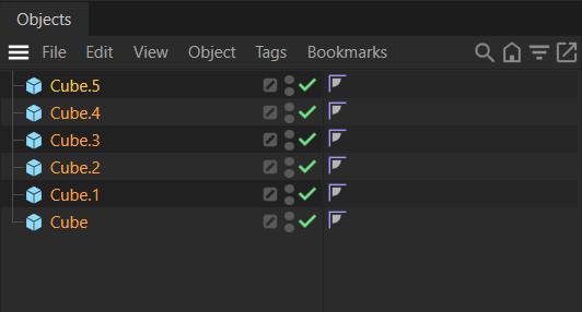

Scene state before the script ran (and also the state after an undo):

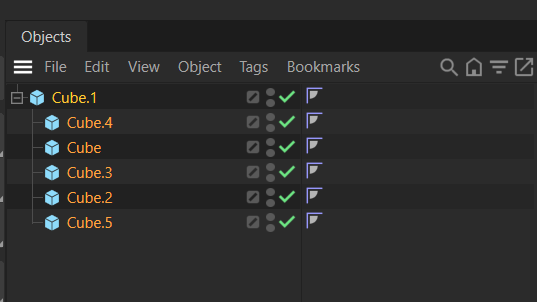

Scene state after the script ran:
