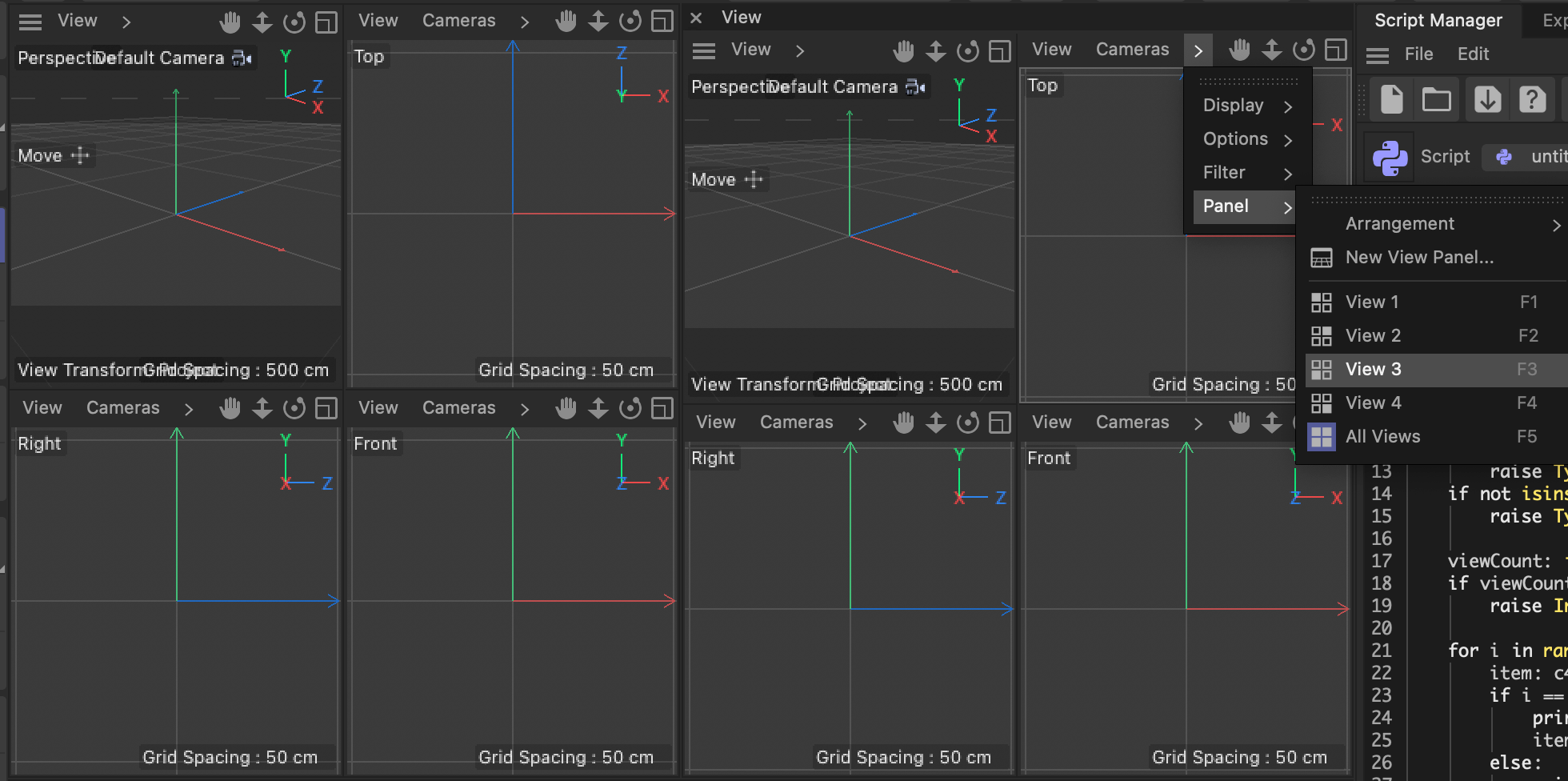

To unpack things a bit, I understood your question as such that you have multiple view panels in your layout and each view panel contains multiple views. The screen below shows two view panels with four views each for example.
You then want to toggle a view panel from showing all its views (depending on the panel layout) to singular one, e.g., "minimize and maximize" the Perspective view in the second panel. For that you wanted to use c4d.CallCommand(13640) and therefore need to set the active view (the view with the grey border).
