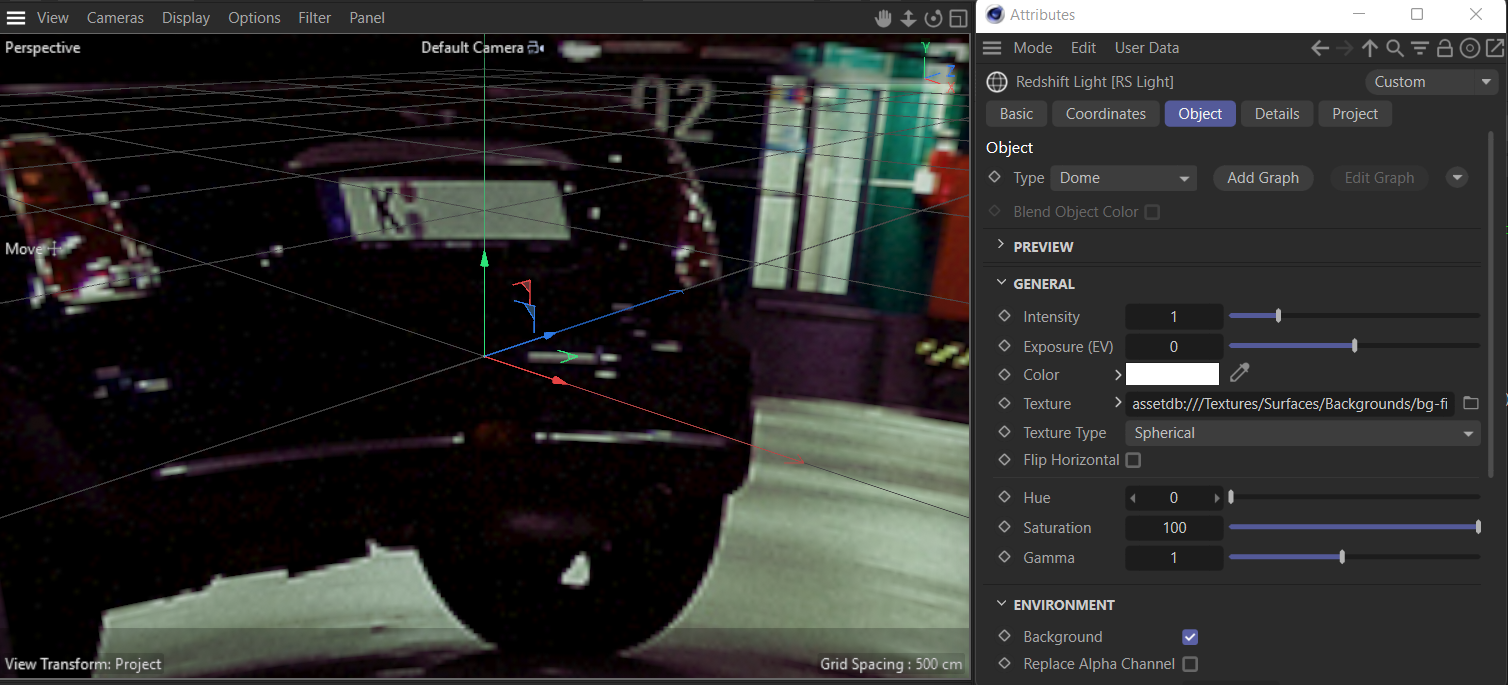

Hello @spedler,
Please excuse the slight delay. Yes, DescID's can be nasty little fellas from time to time. But it is possible to write this Texture.Path sub-channel; find an example at the end of my posting. For me this successfully creates an RS dome light and sets the texture thingy. The underlying gotcha is here - which I did not respect in my hand-wavey 'pseudo-code' - that you must be quite precise from time to time when defining complex DescID instances for them to work in all places.
The example goes over some technical background and hints at a workflow (Python) for how to gather the here required magic numbers on your own.
The result:

Hi Ferdinand,
Thank you very much for this very long and helpful post. It's definitely going above and beyond the usual support. I think TBH it ought to become part of the DescID manual in the SDK docs, it's so useful.
I'll need to peruse it at length to be sure I understand how it all works, but with this I'm sure I can get it working. I'll mark this thread as solved when I do.
Thanks again,
Steve
Just tried the code and got it working now, no problems. Many thanks for taking the time to sort this out for me, very much appreciated!
Steve
Hey @spedler,
I am glad that this solved your problem. Regarding putting this in the docs or SDK: I have created a task for doing this, but there is other stuff in front of the queue, so it might take some time before I find the time to do so.
