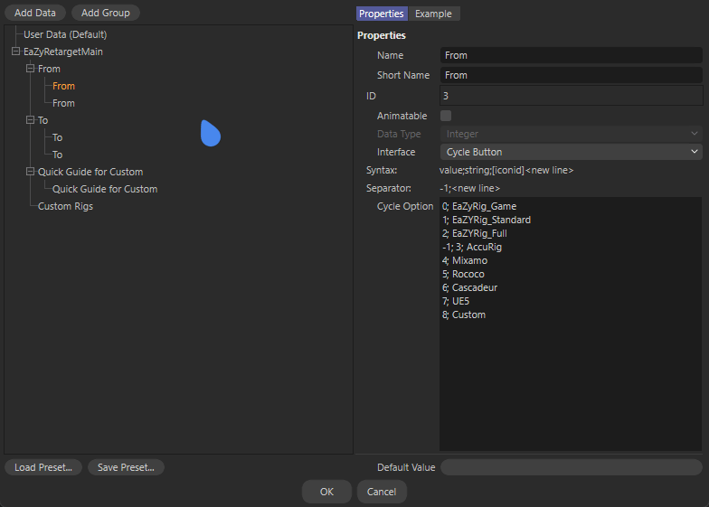

but when I do Groups work fine so do links But all the others are glitched out.

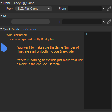

Until I manually go into the user data and fix make a random edit then the integer works But as you can see in the gif Multiline string does not get fixed as shown in the image below

You also seem to generate a malformed user data container, because this is how your setup looks for me (notice the misplaced labels).

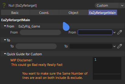

Here is what I get outputted the whole thing is not useable
An isolated code, Expected Behaviour, the Behaviour am getting.
