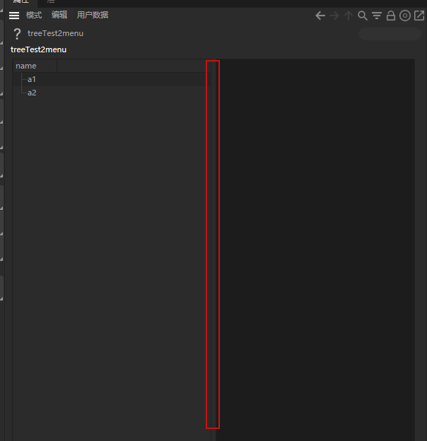

1.is there any way to add a separator in the model of the two control, so I'can drag to resize, like asset browser. 2.how to hide this title? It's seem useless 3.can embed the Dialog like asset browser?
Well, you can also add a separator to make it more visible, but the key thing to do, is to allow weights for a group. When you have this group structure
GROUP ID_MY_WEIGHTED_GROUP { COLUMNS 1; SCALE_H; SCALE_V; ALLOW_WEIGHTS; GROUP ID_SUB_GROUP_A {SCALE_H; SCALE_V;} GROUP ID_SUB_GROUP_B {SCALE_H; SCALE_V;} }
The user can change the height of the groups ID_SUB_GROUP_A and ID_SUB_GROUP_B by dragging between them as you did in your screencast. The relevant flag is here ALLOW_WEIGHTS, and if you want to use code to create the layout, you must pass BFV_GRIDGROUP_ALLOW_WEIGHTS as part of the group flags for the GeDialog.GroupBegin call for ID_MY_WEIGHTED_GROUP. You can also save and load group weights for a dialog with the methods GeDialog.GroupWeightsLoad and .GroupWeightsSave()
This title comes from the ToolData plugin you are implementing. I agree that the duplication of the name is a bit distracting. I am not sure if it has always been there, but for now, you cannot change that.
ToolData
Edit: So, I checked, and the duplication of the title string goes back to at least S22 (I do not have any older versions installed) and was therefore likely always there. It is only that it became more distracting with the new layout, as the contrast between the two strings has increased (could also be that this is just a perception thing with the darker background). This is for example how it looked in R23:
We will see what we can do, but there will not be any immediate fixes, as ToolData itself does not have the highest priority and we will also be reluctant to remove title strings other plugins might rely on.
