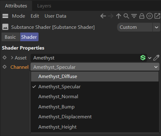

The following code example demonstrates how to discover the channel identifiers of the "Channel" parameter of a Substance shader, so that the channel can be changed programmatically for a substance asset unknown at the time of writing the script.
This question reached us via mail, but since answering it requires no confidential data, we are sharing the solution here. The "trick" is to traverse the description of the shader, as these identifiers depend on the substance.
The result (the example script will randomly select a channel, but with the data provided, channels can also be selected by their name or a substring match as for example "diffuse"):
