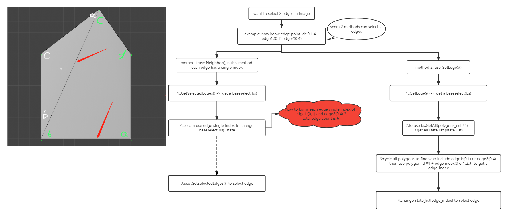

I know how to select a point / face, but I still don't know how to select an edge. Does each edge have a unique ID? For example, two quadrilateral faces have seven edges. If I choose an edge, I can know that its ID is 6.
I have a picture below. I have marked the edges I want to choose, but I don't know what to do. Can have a simple code demonstration?问题.png
Thanks for any help!
Hi @cairyn ,thanks for your help!
I have made some progress, but there are still some problems!
the image_1 show want wo select 2 edges.
image_1:
Through your reply, it seems that I have got 2 directions to solve my problem. I will show it in the following image_2.
image_2:
use method 2 ,can select the edge show on gif_1.
gif_1:
method 2 code:

While points and polygons are objects in C4D that are identified by an index of an array (where the actual point/polygon data is stored), edges are not - they exist only as "inferred" data and will be described through the polygons they belong to, and an "edge index" within that polygon.
If you look at the PolygonObject and the method GetEdgeS(), you will find the text:
"The edges are indexed by 4 * polygon + edge where polygon is the polygon index and edge is the edge index between 0 and 3."
(The docs don't tell, but it's kinda obvious: "edge index" 0 is between points a and b of the polygon, 1 between points b and c, 2 between points c and d, and 3 between points d and a.)
This will result in an "encoded enumeration" (or an ID, if you want) for the edge. (But it's not an index in the sense of points and polygons, as there is no edge data that this index could point to.)

Hi... not sure whether you see a problem in method 2, it seems fine to me (works, too).
(Specifically, it works because FindEdge does not care about the direction of the edge, otherwise the middle edge might give you trouble because it runs 4-0 for poly 0, and 0-4 for poly 1. But you do not need to consider the directionality/normal of the polygon here.)
(Also, border edges are only found once because there is only one polygon they belong to, but that is kinda obvious.)
Now, the biggest issue seems to me that the algorithm needs to find the polygons the edges belong to. AFAIK the PolygonObject does not carry much permanent relationship data between points, polygons, and edges; only the polygon references its point indices. Everything else needs to be found by an existing method or by walking through the whole structure.
The Neighbor class however must be initialized before usage, so in terms of speed, I wonder what is faster... Neighbor may internally initialize structures that you never use, but it is written in C++ so perhaps faster. Addressing the polygon object structure directly would be Python code, so slower, but more targeted. In case of large poly counts this may make a difference... I guess a Maxon person would be able to answer that. (I could measure runtimes directly and investigate, but I don't have the leisure to.)
Let me just look whether I have a fitting example for Neighbor...
Okay, I cobbled together an example for Neighbor, but I found the class more disappointing that I remembered it.
Neighbor doesn't seem to have many functions relating to the internal edge indices: notably, there is no method that returns the edge index for its two end points. This would make the algorithm very short (just look up all the neighbor edge indices for the given point pairs and create a BaseSelect from them).
Instead, you can only use GetEdgePolys to find the (at most) two polygons bordering the edge given by two points. This saves you the explicit loop over all polygons... but from there, you still need to use GetPolygon to retrieve the CPolygon from the indices, then FindEdge to get the poly's edge index, then GetPolyInfo to finally get the edge's neighbor-internal index that you can use in the BaseSelect.
It works, but unfortunately I am not convinced that it is faster or easier to read than method 2. meh
