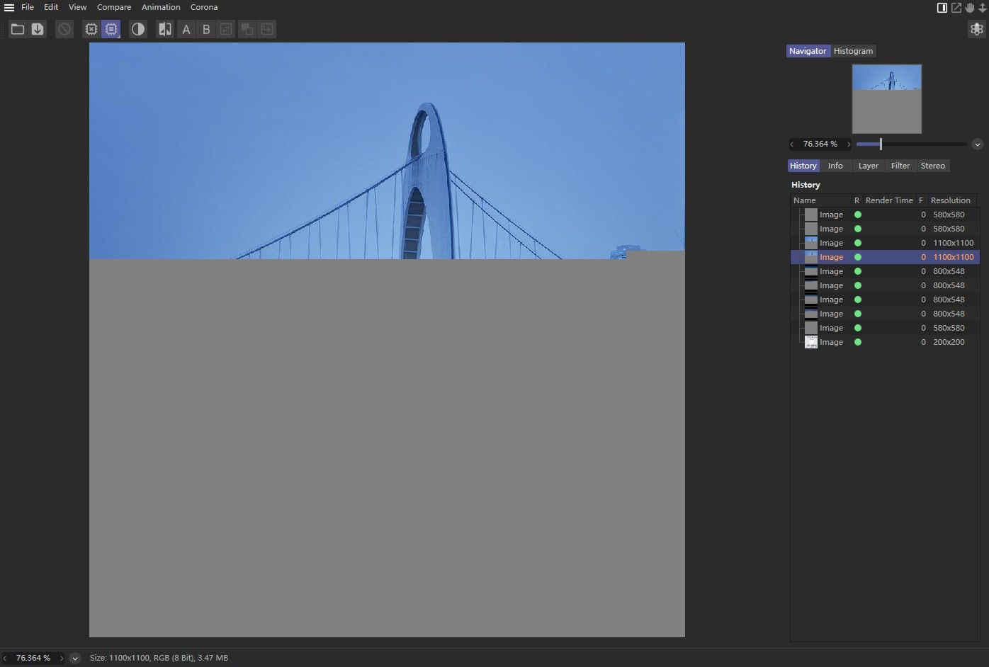

Sometimes it can ShowBitmap() correctly like this:
Sometimes it's can show bitmap but the image is not loaded correctly:
And sometimes it's faild! And the InitWith() result is -6
Is there have some right way to show an image from the URL?
Hello @gheyret,
Thank you for reaching out to us. The reason why this is failing for you is due to you not caching the content you want to put into the BaseBitmap or alternatively not using a high-level-enough interface.
You can download the content of the image at your URL into either a temporary cache file or an in-memory file or use LoadFile and let Cinema 4D handle the rest. Find a simple example for each approach at the end of my posting.
When you are still running into problems, you should first try to see if you can access the whole file in principle. For example, with urllib3 which I am using in the code below.
The result:
The code:
