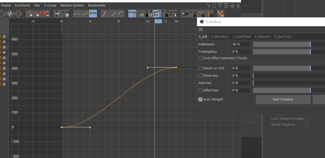

I have been looking for the source of the problem. After seeing your answer, I should have looked in the wrong direction (I always thought that SetTimeLeft() could not accurately transmit the value I calculated). Below I uploaded a GIF to show the problem I encountered more accurately.
1: I use Add key slider to dynamically add functions. It will call my autoweight function by default. It can be seen that in the process of dynamic addition, the error of RightTime == 0 of some key frames appears
2: When I dynamically use EasyInOut slider to perform the smoothing process, it also calls the autoweight function, and it still does not correct the wrong situation
3: When I use c4d's default auto tangent classic for these key frames, then use EasyInOut again to perform the smoothing process, the autoweight function will work normally.
So I don’t know why this happens, because the above code is used to set the key in the autoweight function
It seems that can't see the gif in full,i upload a file ,can be download. easyinout2.gif

thank you for your detailed explanation, but I unfortunately still struggle a bit with the details. I will answer as best as I can from what I do understand.
I assume your major problem are the kinks that are introduced into your spline by incorrect tangents.
  1. Cinema 4D has multiple tangent modes which partially or fully take away the control from the user how the tangents between keys are set. So, when you are in another mode than ID_CKEY_PRESET__CUSTOM or have any of the automatisms enabled in ID_CKEY_PRESET__CUSTOM, then setting the raw tangents with CKey won't help you, as they always set the raw tangents. As lined out before, when you want to set tangents with the automatisms enabled, you must must use the tangent methods attached to CCurve.
  2. When you just want to ensure the smoothness/continuity of your curve, you can also use CCurve.SetTimeLeftAdjustValue and its counter part for the right tangent.
  3. Finally, when you want to construct a smooth spline from a to b with all automatisms turned of, you will have to get your hands dirty yourself. I once posted this example, but this is more complicated than your case, since this was for 3D.
  4. When you just want to subdivide a curve without changing its curvature, we cannot give you any detailed instructions on how the curve interpolation of ours works, but you should get pretty close with the common cubic-bezier curves.
If there are remaining questions, I would propose that you follow the recommended pattern of posting executable example code and line out what you would expect to happen and what happens instead.

In my autoweight function, there is no error in the calculation result of the tangent, but when setting the CKey, there is a problem. It seems that there are too many parameters set, which causes the left and right time values of the key frame to be set according to the calculation results. Then an unknown change was made, causing the final value to not match the calculated value. Although I still don't know why those settings will cause the value to go wrong.
wrong code:
    key.SetInterpolation(curve,c4d.CINTERPOLATION_SPLINE)
    key.SetTimeLeft(curve,L_time_v)
    key.SetValueLeft(curve,TL_vector[1])
    key.SetTimeRight(curve, R_time_v)
    key.SetValueRight(curve, TR_vector[1])
    key[c4d.ID_CKEY_PRESET] = c4d.ID_CKEY_PRESET__CUSTOM
    key.ChangeNBit(c4d.NBIT_CKEY_AUTO, c4d.NBITCONTROL_CLEAR)
    key.ChangeNBit(c4d.NBIT_CKEY_BREAK, c4d.NBITCONTROL_SET)
    key.ChangeNBit(c4d.NBIT_CKEY_KEEPVISUALANGLE, c4d.NBITCONTROL_SET)
current code:
Using the current code, the left and right time values of CKey, the calculated result matches the final result.
this is an print example:
    Calculate_RTime: 0.0301874202486 After_Set_Get_from_Key_RTime 0.03
gif also shows that it is working fine now.
