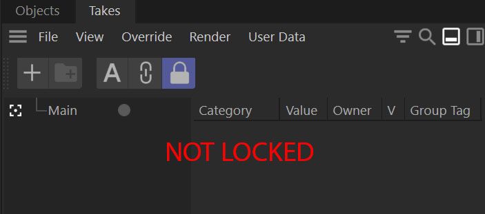

I wrote a small example which demonstrates the steps which must be taken to add takes and overrides for a material assignment. I did not include the asset browser in my example, which I think is part of what you are working on, and instead relied on stuff that is already inside a document.
The result:

However, as you state most things looks fine but still I dont get any overrides on the tags in the takes (yes take is a child take). I tried the same code, but without the typing of what type of tag to find, on a scene where selectiontags are named as the searchterm instead of texturetags. Here it works as intended and the overrides show up on the take. Do you have any idea why this doesn't work when trying to override texturetags?

After some research by @ferdinand the issue was that the file was locked for take overrides. This can easily be missed since the overrides are locked when the button in the UI is disabled and not locked if its active:
I added a check in the plugin to toggle the lock if its "active":
if (!IsCommandChecked(431000108)) {
    CallCommand(431000108);
