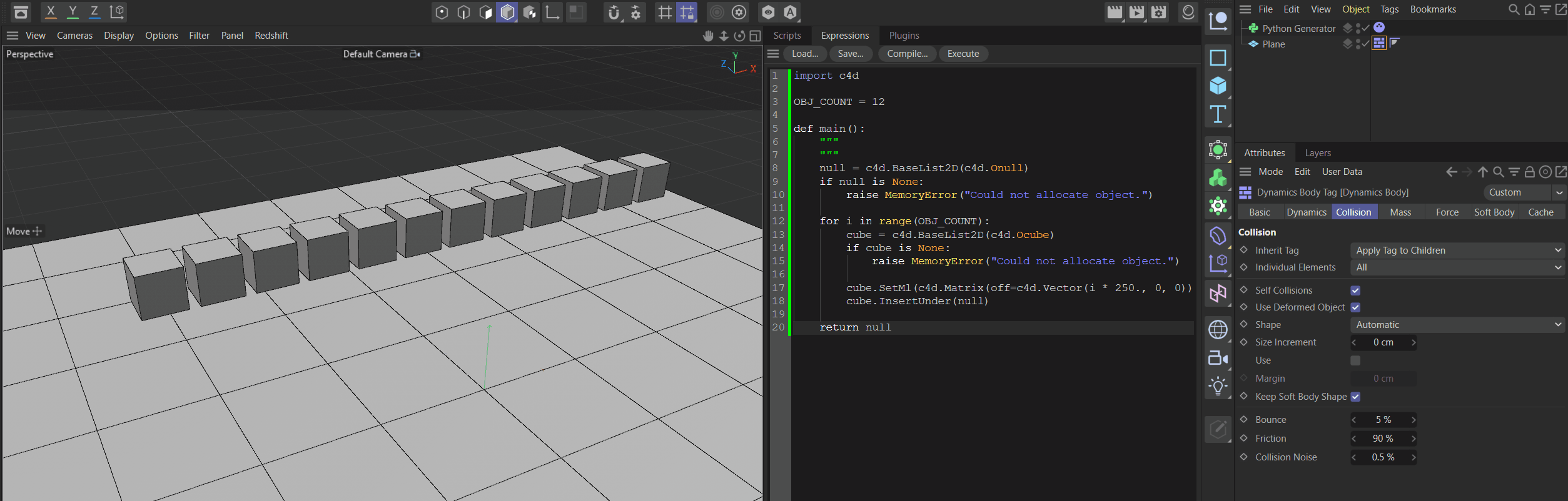

The result:
The code:

The result:
The code:
