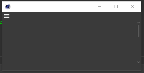

The result:

@ferdinand Mmmm...I still don't get it... there have a GIF to my problem;
I set the minimum value of height to 400 in the GetMinSize() like this:
def GetMinSize(self):
    return 0, 400
It does create the scrollbar, but the vertical range of the scrollbar is limited to 400,this prevents me from using the scroll bar to scroll down to see my all sunjects in the UserArea.
So how do I set the GetMinSize() so that the scrollbar exactly matches UserArea?
