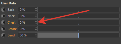

Hello for every one. Does anybody know is it real to set up value for selected user data and for all user data in object?
Solved Set up selected user data value
Hello @ROMAN,
thank you for reaching out to us. We are struggling a bit with understanding your question. I assume you either want to get or set the state of selected parameters in an Attribute Manger, right? This is unfortunately not possible, since there can be more than one Attribute Manger and the information of selection states for items in the Attribute Manger, unlike for the Timeline or Object Manager, is not public. There is also no public interface for the Attribute Manger(s).
When we have misunderstood your question, I would ask you to please clarify what we did misunderstand.
Hello @ROMAN,
@ferdinand Sorry for the late reply. Yes you understood me correctly. Will this be fixed in new c4d versions?
