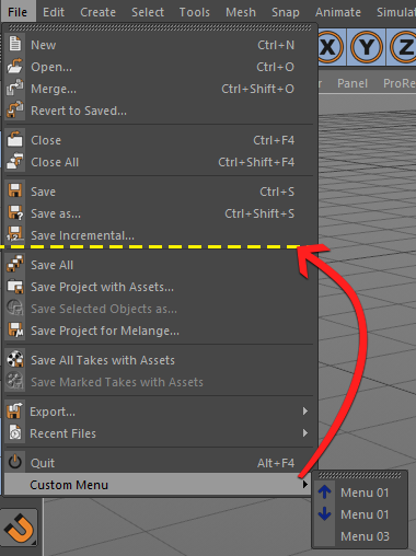

Is it possible to placing a custom menu after specific submenu from the File menu, after the Save submenu for example .
The script bellow insert my custom menu at the bottom of the File menu:

Hi @m_adam,
I found the solution below that allow to inject my custom menu just after the "IDM_SAVEALL" submenu of "File" menu, but the only problem now is with the following line:
FileMenu.InsData(c4d.MENURESOURCE_SUBTITLE, "File")
Because with this solution I must to rebuild all the "IDS_EDITOR_FILE" menu. and I'm searching how to grab the default sub-title of the "IDS_EDITOR_FILE" menu depending on the user interface language. So is there method to get the default subtitle of "IDS_EDITOR_FILE".
Thanks.

Hi @mfersaoui unfortunately, this is not as easy as it sounds in Python.
Find in How to use InsDataAfter in menu a user who wants to add its own item after the "Scroll to first active object" within the Object Manager menu and in the last answers, there is a code snippet to do it.
If you need more specific help or if there is anything you don't understand, please let me know.

@mfersaoui
I found the following solution:
FileMenu = c4d.BaseContainer()
resource = c4d.plugins.GeResource()
resource.InitAsGlobal()
FileMenu.InsData(c4d.MENURESOURCE_SUBTITLE, resource.LoadString(12587))
