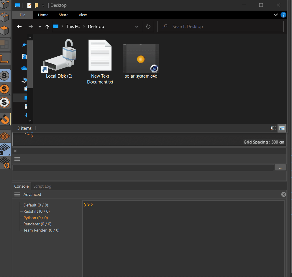

"""Example for creating a CUSTOMGUI_FILENAME in a GeDialog and how to handle drag and drop events. As discussed in: plugincafe.maxon.net/topic/13240 References: [1] developers.maxon.net/docs/Cinema4DCPPSDK/html/class_filename_custom_gui.html """ import c4d ID_FILE_LINK_1 = 1000 class MyDialog(c4d.gui.GeDialog): def CreateLayout(self): """ """ # Add a filename custom GUI to the dialog. You can read more about it # in the C++ documentation [1]. The type itself has not been wrapped # for Python, but you can interact with it as a BaseCustomGui. self.AddCustomGui(ID_FILE_LINK_1, c4d.CUSTOMGUI_FILENAME, "", c4d.BFH_SCALEFIT, 0, 0, c4d.BaseContainer()) return True def Message(self, msg, result): """ """ # When the message id is BFM_ACTION. if msg.GetId() == c4d.BFM_ACTION: # An action send from the filename GUI ID_FILE_LINK_1. if msg[c4d.BFM_ACTION_ID] == ID_FILE_LINK_1: # The newly set file path value. filePath = msg[c4d.BFM_ACTION_VALUE] print(filePath) # You can also access the directly element like so: filePath = self.GetString(ID_FILE_LINK_1) print (filePath) return c4d.gui.GeDialog.Message(self, msg, result) DIALOG = None def main(): global DIALOG DIALOG = MyDialog() DIALOG.Open(dlgtype=c4d.DLG_TYPE_ASYNC, defaultw=500, defaulth=500) if __name__ == '__main__': main()
Its behaviour:
