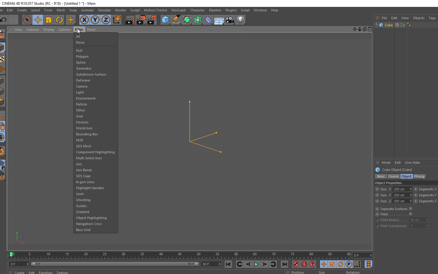

  • Hi @blastframe,
    thank you for reaching out to us. This is unfortunately not supported in R18, even within the app, as demonstrated below.
    And due to R18 having left the support cycle, this will also not be fixed anymore. Your best option is to deselect the object which you do not want to display the handles for.
    Thank you for your understanding,
