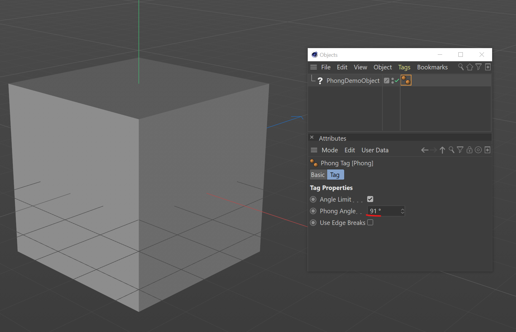

Hi @r_gigante & @zipit,
Thank you both for your replies. I am still experiencing the issue, unfortunately. I can set the Phong angle manually, but I want to set (or override) my object's Phong angle with a tag. As can be seen in this image, the Phong tag is at 91⁰.
It should look like this. (side note: when the object is made editable, it creates a Phong tag with the angle set with SetPhong and deletes the previous one):
@zipit
My issue is not with setting the Phong. My issue is that I cannot surface the Phong tag to the user as is done with the Cinema 4D Primitives. Here is a code example that shows how the Phong tag I'm creating does not associate with the object's Phong tag until it is made editable.
