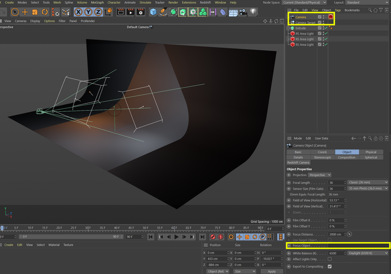

Hi there. I wonder if anyone would be able to help a not-very-savvy coder figure out a tiny bit of Python code. For this code, I’m trying to import and position a camera into my scene. I then want to connect the 'focus distance' field of the camera to a null object which I have also imported into the scene. I thought it would be as easy as adding some variation of "camera[c4d.CAMERAOBJECT_TARGETOBJECT] = null" into my code, but no amount of tweaking seems to work for this. I feel like I'm missing a step. If anyone knows the answer please let me know. My code can be viewed below.

@curripod00 said in Connecting Camera Focus Distance to Null Object with Python:
This line cannot work because "null" is an undefined variable name (and "camera" actually too). It references nothing.
Instead, you will need to find the actual target null by searching:
camera = doc.SearchObject("Camera")
camera[c4d.CAMERAOBJECT_TARGETOBJECT] = doc.SearchObject("Camera_Target")
(I did not test that, just slapped together from memory.)
This is still not very good code because it assumes that the new camera's name is "Camera" which is not very original and may be duplicate in the scene already. Feel free to call the camera something else by setting the name when you generate the object.
Or instead of searching, you store the objects after generation in a variable. Following code should do it (I didn't test, as I don't have Redshift):

@zipit okaaaay I get it: you NEVER EVER sleep! 😀
@zipit This is fantastic, thank you for going through and explaining why my code was lacking, I have a better understanding of this process now and my camera focus works perfectly using your method. 👍 👏
