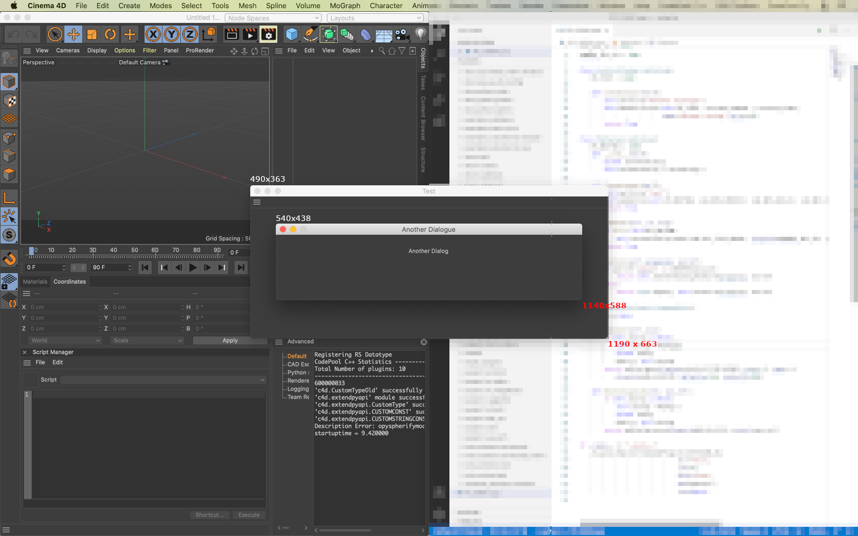

Here are the results:
The Main Dialog (DLG_TYPE_ASYNC) is 324x51 and the secondary dialog (DLG_TYPE_MODAL) is 324x100. This is making layout difficult.

UPDATE:
I'm thinking that the Main Dialog cannot be resized as it is DLG_TYPE_ASYNC. The secondary Dialog is taking the width from the last dragged dimensions of the Main Dialog.
I'm not sure if this is correct, but I was able to get the dimensions I needed for the secondary GeDialog by giving it a unique PLUGIN_ID and removing the subid (code below).
self.anotherDialog.Open(c4d.DLG_TYPE_MODAL, pluginid=ANOTHER_DLG_ID, xpos=-2, ypos=-2, defaultw=600, defaulth=450)
Do I need to create a unique PLUGIN_ID for every GeDialog or is there another way?
Hi @blastframe thanks for writing us.
Yes, as stated in your second post having unique ids for the different dialog is the safer way to prevent unexpected behavior like the one reported initially. Tested successfully (both main (async) dialog and modal dialog were correctly sized and placed on mac and windows) I also confirm there's no need to specify the subid.
