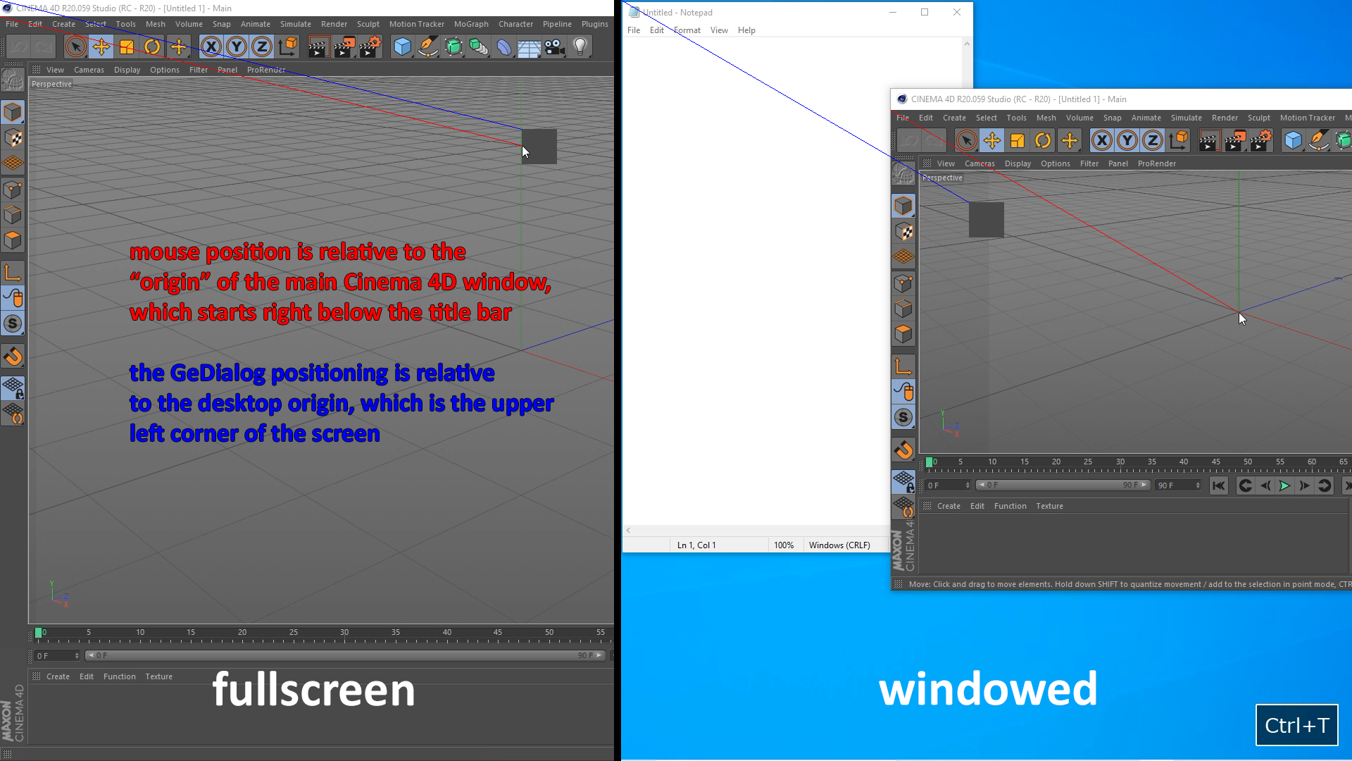

    One would expect that the dialog would be positioned exactly at the current mouse position ...
    Following is a screenshot showing the result of activating the plugin when Cinema4D is in fullscreen, and when windowed. It clearly shows that the obtained mouse coordinates, used to position the dialog, are relative to one point, while the positioning of the dialog itself uses a different origin.
    Obviously, it would make more sense that both coordinate system uses the same origin ... but I guess that would make things just too simple.
