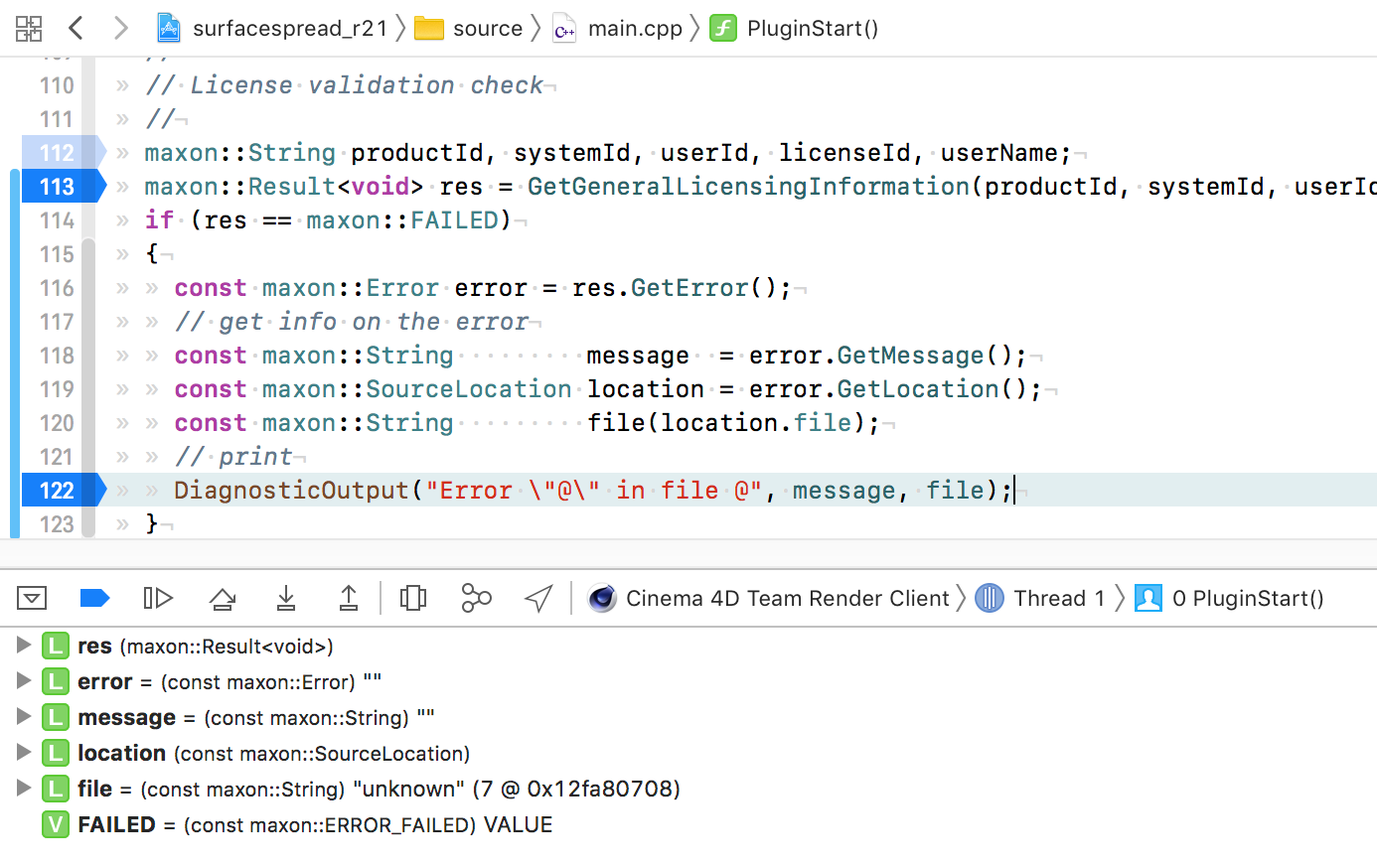

Well, what error does GetGeneralLicensingInformation() return? You can check the error message: Error Class
The way it's described in the SDK docs, I do not get any error message:
By diving into the location in the API where the error is thrown, I might have found that it's a nullptr error.
