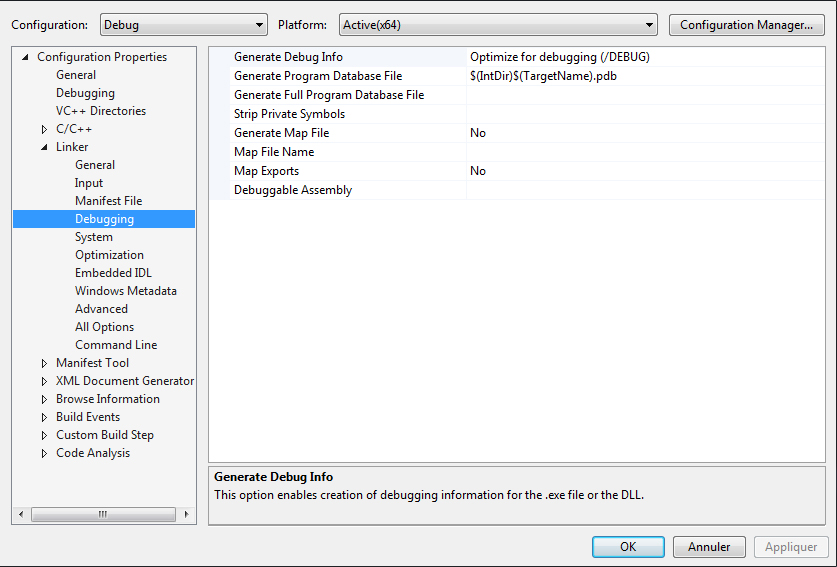

What do your settings say under Linker/Debugging? The tabs you show here seem perfectly fine to me...

Here is screenshot of the Linker/Debugging panel:
Looks just like mine, so no errors there.
Okay, last try for today: Is your plugin project in the project explorer displayed as bold text? If not, try context menu -> Set as start project (or however the menu point is called in English)
If that doesn't work either, I need to leave the issue to the specialists 😉
