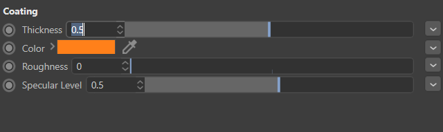

The view that I get is the picture below but as you can see the paramters (Thickness, Color, Roughness etc) are not aligned as they normally do when using description resource.
How would the code or res file look like so I can have them aligned.
unless I am missing something here, I would say that this behaviour has nothing to do with modifying your description via GetDDescription() but the structure of your res file. The alignment of description elements always works per GROUP. So when you encapsulate every row in a GROUP you will have no alignment at all.

@zipit the reason why I have to use GROUP for every row is because at every row I am adding a popup button. And I can not add it using res file. So I can't do this without a group which tells me where to add the popup button.
Thanks @zipit,
Managed to solve it thanks to you.
