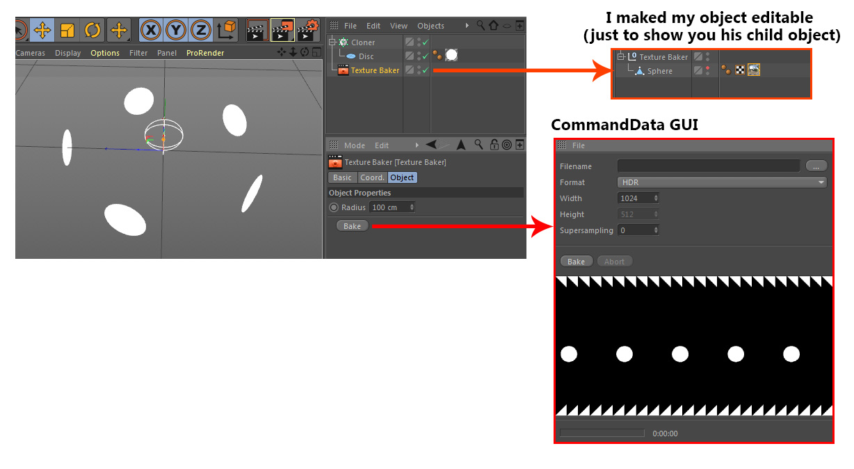

    If I go for a temporary document, I must to copy all objects of the current doc (scene) to the temp doc. In my situation I want to bake only the reflection channel of my texture, if there only the cloned object "op.GetCache().GetDown().GetClone()", there no thing to reflecte on my texture reflection.
    # Bake only reflection
    bakeData[c4d.BAKE_TEX_REFLECTION] = True
    For that reason I get a black image in the bake texture result.
    Regards,
    Mustapha

  • Hi @m_adam,
    I have a first button on my ObjectData that call my Bake Texture CommandData plugin (I'm using this example: py-texture_baker_r18.), and then from the CommandData GUI I run the bake texture process to bake the reflection channel of the sphere object texture.

  • @m_adam
    Yes, it's the method that I'm using, but I don't know if this allowed or no. I explain it above in my second message.
    And response to @zipit about "I do not know how to bake a parametric object" I mean: I do not know how to bake texture of an object (sphere) without make it editable.
