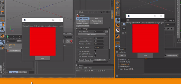

Here a gif showing the problem, left side R18, right side R21
Main difference:
It seems R21 is not even updating the console for each print, it just updates when script ends

No solution? mm No way to force update of the dialog/console during the script as R18 behaves? to see each print at the right moment instead of waiting untild end of script or a modal dialog to appear to update dialog/console?
hello,
i can confirm the issue here even in c++.
There are two issue here.
The python console have been changed a lot. Printing out things in the console is really slow. (in general)
With the last versions, you can print out lots of data and it doesn't block your code. That's why your loop execute really faster in R20/21 than on previous version.
There's no "flag" to make the console act as before.
The BitmapButton not updating is a lot more important and look like a bug.
This is under investigation and I'll be back to confirm if it's a bug. (both issue)
Manuel.
