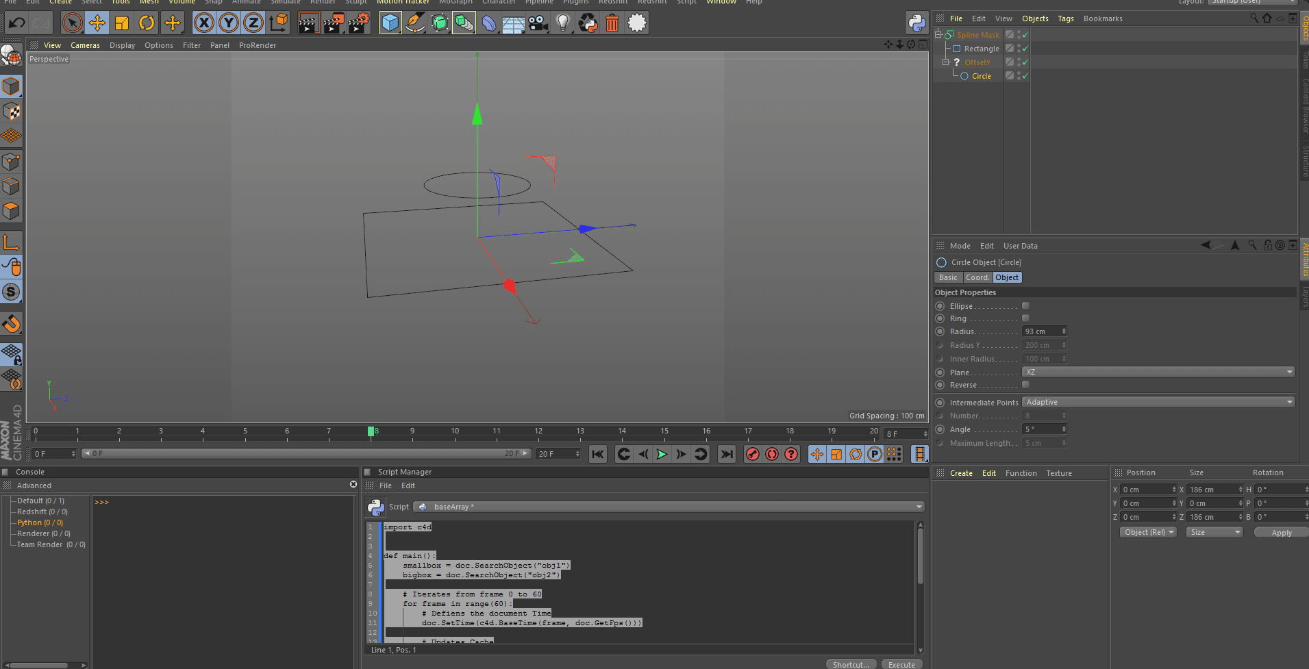

Hello, I'm trying to get the Spline Objects from the child objects of a Object Plugin I'm making, then I want to modify them and return them vie GetContour(). I've been using GetRealSpline() and that has been working pretty well, but there are a couple cases that it doesn't work.
If I have a Instance Object then GetRealSpline() won't correctly get the referenced spline object. I'm trying to solve this in c++ but it's really easy to show in Python. Illustrated by the Python sdk example and a super simple C4D Scene :
from c4d import gui
  realSpline = op.GetRealSpline()               # Active object is a primitive spline object
  if realSpline is not None:
    doc.InsertObject(realSpline.GetClone())     # Insert the clone of the created spline object in the document
# Execute main()
if __name__=='__main__':
Circle returns a spline, but Circle Instance doesn't and I get the same results in C++. I've been looking into GetAndCheckHierarchyClone() and it seems like that would get me the proper object to use GetRealSpline(). on. But GetAndCheckHierarchyClone() needs HierarchyHelp which is in GVO(), but since I'm working with a spline I've been using GetContour() for my work.
So my question is in C++, if I should be using GetAndCheckHierarchyClone(), and if so how would I get access to HierarchyHelp help or if there is a different way to reliably get the Spline Object from a child object.
Thanks for taking a look,
Dan

Hi Daniel,
For the instance object you have to retrieve the link then call GetRealSpline on the linked object since as the name says, it's an instance so the geometry does not really exist.
    op = doc.GetActiveObject()
    if op is None:
        raise TypeError("Failed to retrieves op")
    if isinstance(op, c4d.InstanceObject):
        op = op.GetReferenceObject(op.GetDocument())
